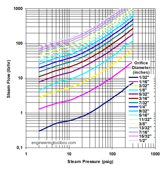

Steam flow rates can be measured by using orifice plates. The diagram below indicates steam flow rate (lbs/hr) through orifices ranging diameter 1/32" to 1/2" and 2 - 300 psig steam line pressure.
Downstream pressure equals atmospheric pressure.
Steam flow rate through orifices - diagram psi

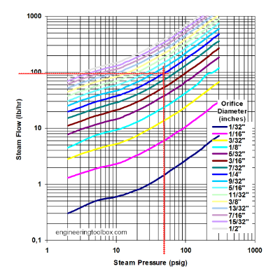

Example - Steam Flow through a 1/4" orifice discharging to the atmosphere - steam pressure 50 psi
Steam flow through orifices - example diagram psi
By drawing the lines as in the chart above - the discharged steam flow can be estimated to
aprox. 98 lb/h
