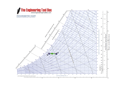

The Direct Evaporative Cooling Process in a Psychrometric Chart
Air at with dry bulb temperature 70 oF and relative moisture 60% (state A) is cooled down (state B) by evaporating water. The process is indicated in the psychrometric chart below.
direct evaporative cooling of air psychrometric chart
With 100% humidification of the air - the dry bulb temperature will approach 61 oF.

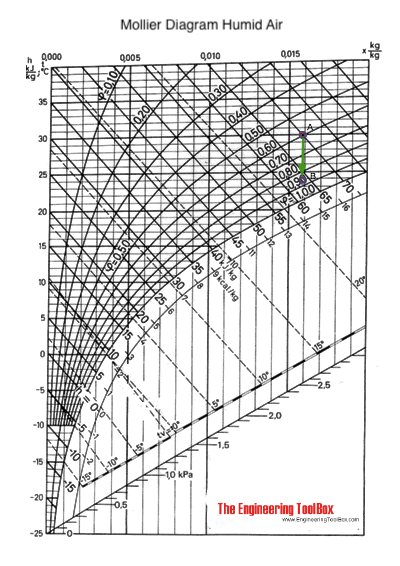

The Direct Evaporative Cooling Process in a Mollier Diagram
Air with dry bulb temperature 30 oC and relative moisture 60% (state A) is cooled down (state B) by evaporating water. The process is indicated in the Mollier diagram below.
direct evaporative cooling of air mollier diagram
With 100% humidification of the air - the dry bulb temperature will approach 23.5 oC.
