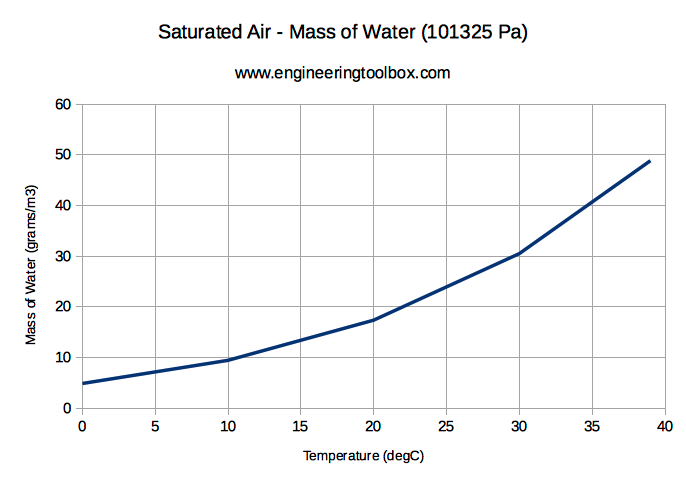

Saturated Air and Mass of Water
Saturated air and mass of water
