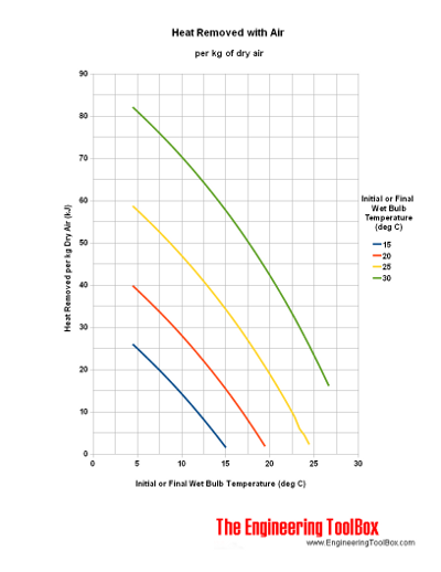

Heat Transported by Air - kJ per kg
heat removed by air - wet dry bulb temperature - kJ
Example - Heat Removed by Moist Air
Air with initial wet bulb temperature 30oC (green line) is cooled down to a final temperature 10oC. From the diagram above we can estimate that
aprox. 70 kJ
of heat is removed.

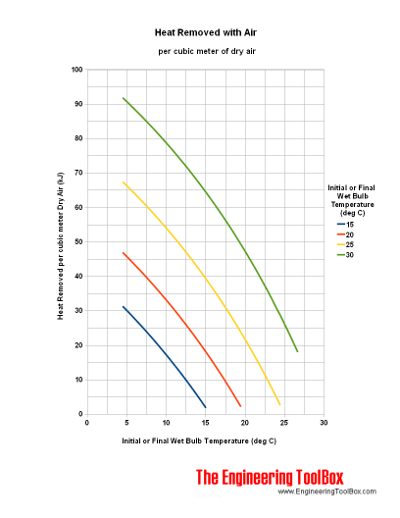

Heat Transported by Air - kJ per m3

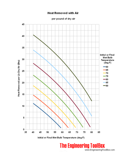

Heat Transported by Air - Btu per lb
heat removed by air - wet dry bulb temperature - Btu

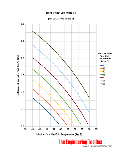

Heat Transported by Air - Btu per Cu. Ft.
heat removed by air - wet dry bulb temperature - Btu per cubic feet
