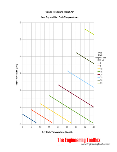

Vapor pressure in moist air vs. wet and dry bulb temperatures are indicated in the charts below:
Vapor Pressure - kPa
vapor pressure moist air kPa

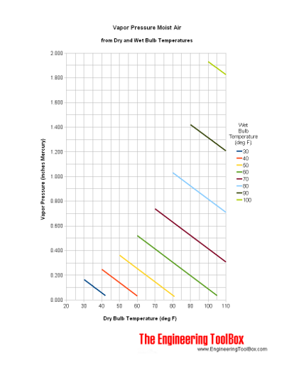

Vapor Pressure - inches Mercury
vapor pressure moist air inches mercury
