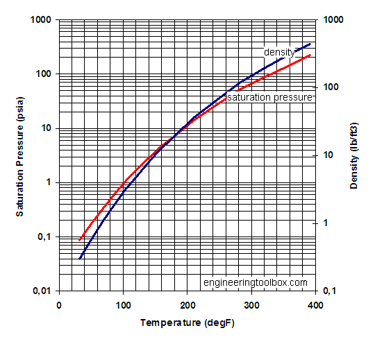

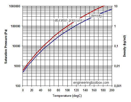

Saturation pressure and density of water vapor for common temperatures
Water vapor - temperature saturation pressure diagram
