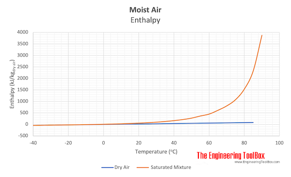

Moist air enthalpy - dry and saturated air mixture
