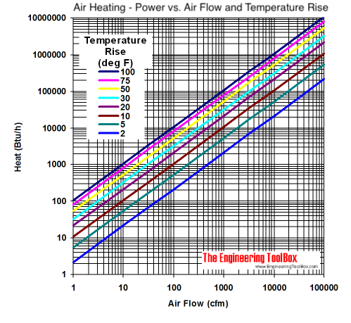

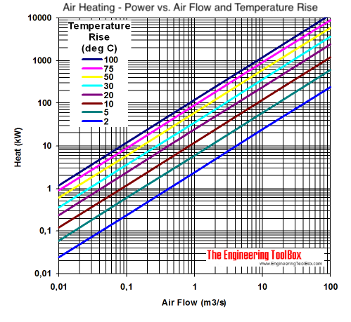

Air Heating - Temperature Rise Diagram
The diagrams below are calculated from the equations above and can be used to estimate heat required to rise temperature in air flows.
SI units - kW, m3 /s and oC
air heating temperature kw diagram
Imperial units - Btu/h, cfm and oF
Air heating temperature btu/h diagram
