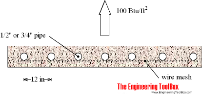

Coils in Concrete Layers
  • entering temperature to the melting coils should be in range 120 - 130oF (50 - 55oF)
  • distance between the coils should not exceed 12 inches (0.30 m)
  • length of the coil should not exceed 140 feet (42 m) if 1/2" pipes are used. If 3/4" pipes are used the coil length can be extended to 280 feet (84 m)
  • heating capacity is increased to 200 Btu per hour per square feet if the length with 1/2" tubes are reduced to 60 feet (150 feet with 3/4")
  • concrete thickness above the tubes should be in range 1 1/4" to 1 1/2" (3 - 4 cm). The concrete layer must be reinforced with a wire mesh
