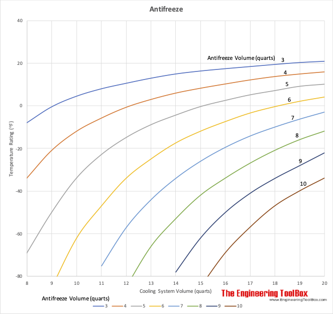

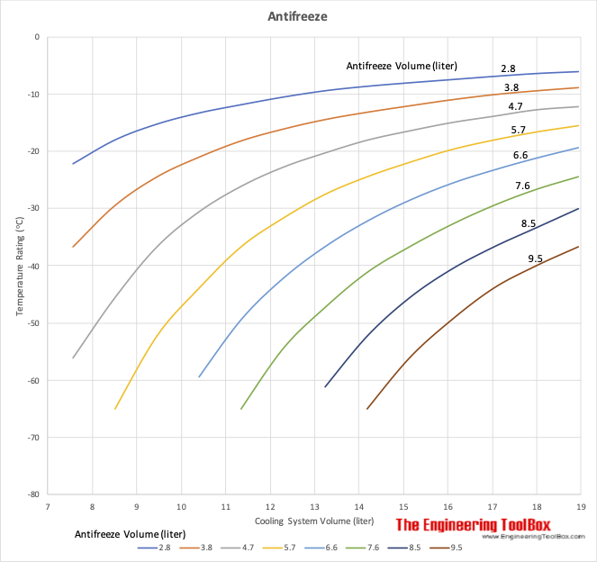

Required amount of antifreeze to protect cooling systems at specific temperature ratings can be estimated from the charts below:
Cooling system - protection temperature and required amount of antifreeze

Never use more than 70% antifreeze in a cooling system.
Antifreeze - Volume and Temperature rating  - liter celsius
