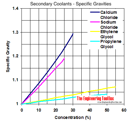

The diagrams below can be used to compare specific gravity, freezing points and viscosity of secondary coolants
Specific Gravities
Specific gravity diagram - calcium chloride, sodium chloride, ethylene glycol and propylene glycol

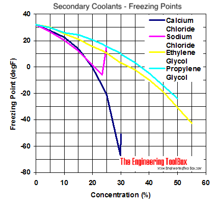

Freezing Points
Freezing points diagram -  calcium chloride, sodium chloride, ethylene glycol and propylene glycol
  • tC = 5/9(tF - 32)

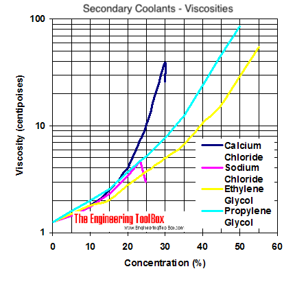

Viscosities
Viscosity diagram - calcium chloride, sodium chloride, ethylene glycol and propylene glycol
