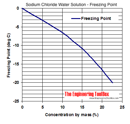

Freezing Point
Sodium chloride water coolant - freezing point diagram

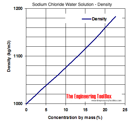

Density
Sodium chloride water coolant - density diagram

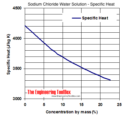

Specific Heat
Sodium chloride water coolant - specific heat diagram
