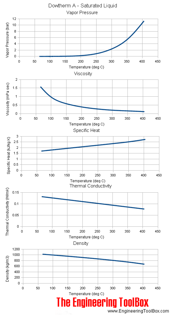

Dowtherm A - Saturated Liquid Properties Chart
Vapor Pressure, Viscosity, Specific Heat, Thermal Conductivity and Density are indicated in the chart below:
Dowtherm A Saturated Liquid Properties Chart
