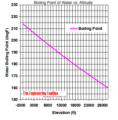

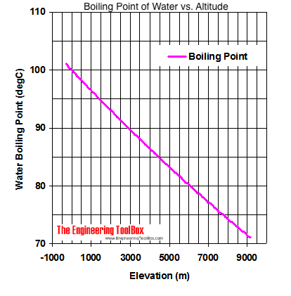

The boiling point of water decreases with altitude:
Boiling point water (fahrenheit) versus altitude (feet)
Boiling point water (celsius) versus altitude (m)
