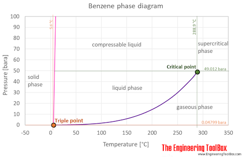

Benzene is a liquid at standard conditions. However, if heated it becomes a gas, and when cooled it becomes a solid. The phase diagram for benzene shows the phase behavior with changes in temperature and pressure. The curve between the critical point and the triple point shows the benzene boiling point with changes in pressure. It also shows the saturation pressure with changes in temperature.
Benzene phase diagram
