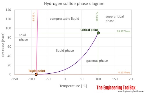

Hydrogen sulfide is a gas at standard conditions. However, at low temperature and/or high pressures the gas becomes a liquid or a solid.
The hydrogen sulfide phase diagram shows the phase behavior with changes in temperature and pressure. The curve between the critical point and the triple point shows the hydrogen sulfide boiling point with changes in pressure. It also shows the saturation pressure with changes in temperature.
Hydrogen sulfide phase diagram C
