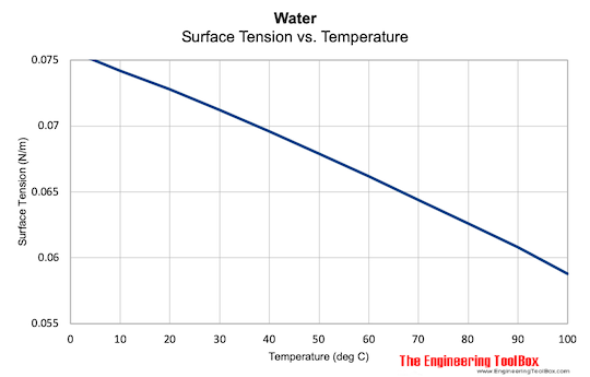

Surface Tension of Water
Surface tension of water at some temperatures:
Water - Surface Tension vs. Temperature
Temperature
(oC)
Surface Tension
- σ -
(N/m)
0 0.0757
10 0.0742
20 0.0728
30 0.0712
40 0.0696
50 0.0679
60 0.0662
70 0.0644
80 0.0626
90 0.0608
100 0.0588
water surface tension vstemperature
