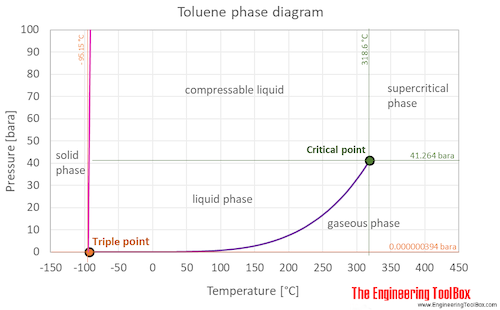

The phase diagram of toluene is shown below the table.

Toluene is a liquid at standard conditions. However, if heated it becomes a gas, and when cooled it becomes a solid. The phase diagram for toluene shows the phase behavior with changes in temperature and pressure. The curve between the critical point and the triple point shows the toluene boiling point with changes in pressure. It also shows the saturation pressure with changes in temperature.
Toluene phase diagram
