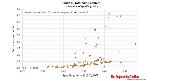

Hydrocarbons, light end Sulfur, mercaptans
Hydrogen content Sulfur, total

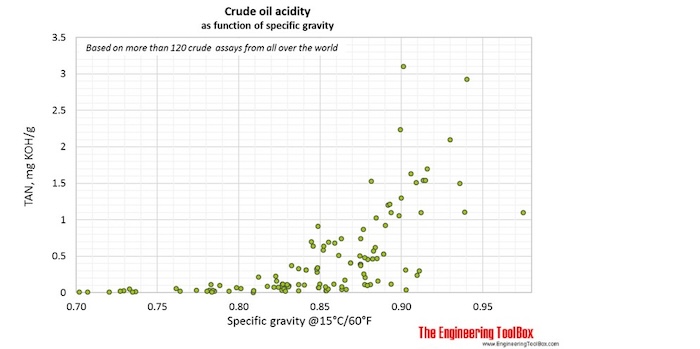

Acidity, TAN - total acid number
What:
The determination of the sum of all acid compounds present in petroleum samples. TAN is expressed in mg of KOH per g of sample.  The acid number is a measure of the amount of acidic substance in the oil.
Why:
The TAN value indicates to the crude oil refinery the potential of corrosion problems. It is usually the naphthenic acids in the crude oil that cause corrosion problems. This type of corrosion is referred to as naphthenic acid corrosion (NAC).
How:
ASTM D664 Standard Test Method for Acid Number of Petroleum Products by Potentiometric Titration:
The sample is dissolved in toluene and propanol with a little water and titrated with alcoholic potassium hydroxide. A glass electrode and reference electrode is immersed in the sample and connected to a voltmeter/potentiometer. The meter reading (in millivolts) is plotted against the volume of titrant. The end point is taken at the distinct inflection of the resulting titration curve corresponding to the basic buffer solution.
Alternative test methods: ISO 6618, ASTM D974, BS DIN EN 12634, IP 449
Typical range of variation: TAN of 0.01 - 3.0  mg KOH/g in crude oil
Crude TAN

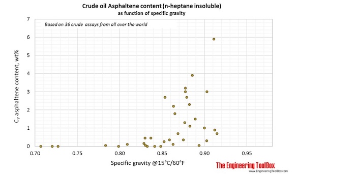

Asphaltenes, C 7
What:
Determination of the heptane insoluble asphaltene content of gas oil, diesel fuel, residual fuel oils, lubricating oil, bitumen, and crude petroleum that has been topped to an oil temperature of 260°C.
Why:
Asphaltenes are the organic molecules of highest molecular mass and carbon-hydrogen ratio normally occurring in crude petroleum and petroleum products containing residual material. They may give problems during storage and handling if the suspension of asphaltene molecules is disturbed through excess stress or incompatibility. They are also the last molecules in a product to combust completely, and thus may be one indicator of black smoke propensity. Their composition normally includes a disproportionately high quantity of the sulfur, nitrogen, and metals present in the crude petroleum or petroleum product.
How:
ASTM D6560 Standard Test Method for Determination of Asphaltenes (Heptane Insolubles) in Crude Petroleum and Petroleum Products:
A test portion of the sample is mixed with heptane and the mixture heated under reflux, and the precipitated asphaltenes, waxy substances, and inorganic material are collected on a filter paper. The waxy substances are removed by washing with hot heptane in an extractor. After removal of the waxy substances, the asphaltenes are separated from the inorganic material by dissolution in hot
toluene, the extraction solvent is evaporated, and the asphaltenes weighed.
Alternative test methods: ASTM D3279
Typical range of variation: 0 - 10 wt% C7 insoluble asphaltenes in crude oil
asphaltenes_crude

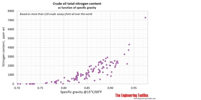

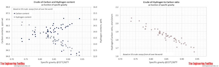

Carbon, hydrogen and nitrogen content
What:
Instrumental determination of carbon, hydrogen, and nitrogen in laboratory samples of crude oil, petroleum products and lubricants. Values obtained represent the total carbon, the total hydrogen, and the total nitrogen. These test methods were tested in the concentration range of at least 75 to 87 mass % for carbon, at least 9 to 16 mass % for hydrogen, and <0.1 mass="" to="" 2="" for="" nitrogen="" --0="" 1--="">
Why:
Carbon, hydrogen, and particularly nitrogen analyses are useful in determining the complex nature of sample types covered by this test method. The CHN results can be used to estimate the processing and refining potentials and yields in the petrochemical industry. The concentration of nitrogen in petroleum product is a measure of the presence of nitrogen containing additives. Knowledge of its concentration can be used to predict performance. Crude oil and some petroleum products also contain naturally occurring nitrogen. Knowledge of hydrogen content in samples is helpful in addressing their performance characteristics. Hydrogen to carbon ratio is useful to assess the performance of upgrading processes.
How:
ASTM D5291 Standard Test Methods for Instrumental Determination of Carbon, Hydrogen, and Nitrogen in Petroleum Products and Lubricants:
A variety of instrumental components and configurations can be satisfactorily utilized for these test methods. Functionally, the following are specified for all instruments: The conditions for combustion of the sample must be such that the subject components are completely converted to carbon dioxide, water vapor, and nitrogen or nitrogen oxides. Instrumental conditions include availability of the oxidant, temperature, and time. Representative aliquots of the combustion gases must then be treated to liberate (as water vapor) hydrogen present as hydrogen halides and sulfur oxyacids, and to reduce (to the element) nitrogen present as nitrogen oxides. The water vapor and nitrogen so obtained must be included with the materials originally present in these aliquots. Additional treatment of the aliquots (prior to detection) depends on the detection scheme utilized for the instrument. The detection system must determine the analytical gases individually and without interference. The detectors must provide linear responses with respect to concentration over the full range of possible concentrations from the applicable samples, or the system must include provisions for appropriately evaluating nonlinear responses so that they can be accurately correlated with these concentrations. The instrument must include an appropriate readout device for the detector responses.
Carbon:     84 - 87 wt% Carbon in crude oil
Hydrogen:  12 - 15 wt% Hydrogen in crude oil
Nitrogen:   100 - 4000 mg/kg Nitrogen in crude oil (lower in condensates)
Crude carbon and hydrogen content
Crude oil nitrogen content as function of gravity

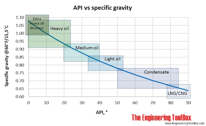

Density@15°C  ( Gravity )
What:
Determination of the density or relative density of petroleum distillates and viscous oils that can be handled in a normal fashion as liquids at test temperatures between 15 and 35°C. Its application is restricted to liquids with vapor pressures below 600 mm Hg (80 kPa) and viscosities below about 15 000 cSt (mm2/s) at the temperature of test.
Why:
Density: Mass of a substance per unit volume. Density is a fundamental physical property that can be used in conjunction with other properties to characterize both the light and heavy fractions of petroleum and petroleum products. Determination of the density or relative density of petroleum and its products is necessary for the conversion of measured volumes to volumes at the standard temperature of 15°C. Density is important for consistency and good fuel economy. Higher density produces more power and more smoke.
How:
ASTM D4052 Standard Test Method for Density and Relative Density of Liquids by Digital Density Meter:
A small volume of liquid sample is introduced into an oscillating sample tube and the change in oscillating frequency caused by the change in the mass of the tube is used in conjunction with calibration data to determine the density of the sample.
Alternative test methods: ASTM D1298, IP 160 and IP 365, ISO 3675, ISO 12185, JIS K 2249
Typical range of variation: 700 - 1000 kg/m3 or 10 - 70 °API for crude oils at 15°C (D ue to high viscosity, t he most heavy crude oils are diluted to lower gravity befor e introduction to the marked)
API_gravity

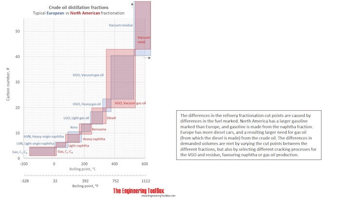

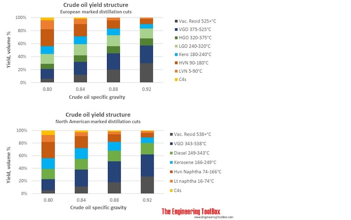

Distillation
What:
Method D2892 covers the procedure for the distillation of stabilized crude petroleum to a final cut temperature of 400 °C Atmospheric Equivalent Temperature (AET). Method D5236 covers the procedure for distillation of heavy hydrocarbon mixtures having initial boiling points greater than 150°C (300°F), such as heavy crude oils, petroleum distillates, residues, and synthetic mixtures. These two methods are combined to give a complete distilliation of whole crudes to atmospheric and vacuum fractions.
Why:
Distillation (volatility) characteristics of hydrocarbons are important for their safety and performance. The boiling range gives information on the composition, properties and  behavior during storage and use. Volatility is the major determinant of the tendency of a hydrocarbon mixture to produce potentially explosive vapors. These tests are conducted on a crude oil to determine its value. It provides an estimate of the yields of fractions of various boiling ranges and is therefore valuable in technical discussions of a commercial nature. These test methods correspond to the standard laboratory distillation efficiency referred to as 15/5. The fractions produced can be analyzed as produced or combined to produce samples for analytical studies, engineering, and product quality evaluations. The preparation and evaluation of such blends is not part of this test method.
How:
ASTM D2892 Standard Test Method for Distillation of Crude Petroleum (15-Theoretical Plate Column):
A weighed sample of 1 to 30 L of stabilized crude petroleum is distilled to a maximum temperature of 400°C AET in a fractionating column having an efficiency at totalreflux of at least 14, but not greater than 18, theoretical plates. A reflux ratio of 5:1 is maintained at all operating pressures, except that at the lowest operating pressures be-tween 0.674 and 0.27 kPa (5 and 2 mm Hg), a reflux ratio of 2:1 is optional. In cooperative testing or in cases of dispute, thestages of low pressure, the reflux ratios, and the temperaturesof cut points must be mutually agreed upon by the interestedparties prior to beginning the distillation. Observations of temperature, pressure, and other variables are recorded at intervals and at the end of eachcut or fraction. The mass and density of each cut or fractio are obtained. Distillation yields by mass are calculated from the mass of all fractions, including liquified gas cut and theresidue. Distillation yields by volume of all fractions and the residue at 15°C are calculated from mass and density. From these data the TBP curves in mass or volume %, or both, versus AET are drawn.
ASTM D5236 Standard Test Method for Distillation of Heavy Hydrocarbon Mixtures (Vacuum Potstill Method):
A weighed volume of sample is distilled at absolute pressures between 6.6 and 0.013 kPa (50 and 0.1 mm Hg) at specified distillation rates. Cuts are taken at preselected temperatures. Records of vapor temperature, operating pressure, and other variables are made at intervals, including at each cutpoint. The mass of each fraction is obtained. Distillation yields by mass are calculated from the mass of each fraction relative to the total mass recovery. The density of each fraction is obtained. Distillation yields by volume are calculated from the volume computed for each fraction at 15°C (59°F) relative to the total recovery.
Alternative test methods: ISO 3405, JIS K 2258, ASTM D2887, ASTM 7169, IP 545
Typical range of variation :
The volume of the different distillation fractions vary a lot from light to heavy crudes. There are two ways to compare crude fraction yields:
1. The temperatures where a certain volume fraction has been recovered in the distillation. The lowest temperature for the lightest crudes:
5% recovery:       15-150°C
10% recovery:     25-220°C
50% recovery:     65-450°C
90% recovery:    160-700°C
95% recovery:    210-760°C
2. The volume fractions recovered at certain temperature intervals. Light crudes contain most naphtha, kerosene and gas oil while heavy crudes have most gas oil, vacuum gasoil and residue :
Gas (C 4 -), -16°C (-60°F):                                      0-5 vol%
Light naphtha, 16-74°C (60 - 165°F):                    0-55 vol%
Heavy naphtha, 74-166°C  (165-330°F):                5-45 vol%
Kerosene, 166-249°C  (330-480°C):                     3-30 vol%
Gas oil (diesel), 249-343 °C (480-650°F):             2-35 vol%
Vacuum gas oil (VGO), 343-538°C (650-1000°F):  1-40 vol%
Vacuum residue, 538°C+  (1000°F+):                   0-35 vol%
Crude oil yield structure with increasing density of crude Crude_fractions_EU_ USA
Back to Content Yield structure of crude oils with increasing density of crude

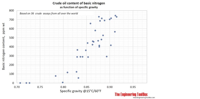

Nitrogen, basic
What:
A method for determining basic organic nitrogen in petroleum distillates. This method may be applied to both colored and clear samples with no difficulty. The range of detection for petroleum distillates is from 0.0001 to 1.0 mass-% nitrogen, while for viscous materials, such as heavy oils, the range is 0.001 to 5.00 mass-% nitrogen. This method may give erroneous results for materials containing bases other than nitrogen compounds (e.g., caustic-washed distillates containing sodium soaps, or crude oil containing inorganic bases).
Why:
Basic nitrogen compounds can act as catalyst poison in refinery upgrading processes, as they adsorb to the catalyst acidic sites. It is therefor of importance for the refiners to know the content of basic nitrogen to be able to optimize the processes.
How:
UOP269 Nitrogen Bases in Hydrocarbons by Potentiometric Titration:
The organic nitrogen bases are titrated potentiometrically using a pH electrode and perchloric and acetic acids as titration and solvents.
Typical range of variation : 0 - 1000 mg/kg basic nitrogen in crude oils  (typically 20-35% of total nitrogen)
Crude oil basic nitrogen content as function of gravity

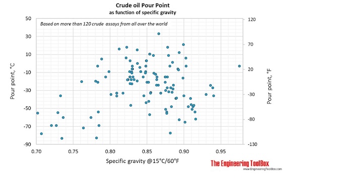

Pour point
What:
Determination of the pour point temperatures of crude oils down to − 36°C. Procedure A provides a measure of the maximum (upper) pour point temperature.  Procedure B  provides a measure of the minimum (lower) pour point temperature. The use of this test method is limited to use for crude oils.
Why:
The pour point of a crude oil is an index of the lowest temperature of handleability for certain applications. This is the only pour point method specifically designed for crude oils. The maximum and minimum pour point temperatures provide a temperature window where a crude oil, depending on its thermal history, might appear in the liquid as well as the solid state. The test method can be used to supplement other measurements of co Phosphorus in gasoline will damage catalytic convertors used in automotive emission control systems, and its level therefore is kept low.
How:
ASTM D5853 Standard Test Method for Pour Point of Crude Oils:
After preliminary heating, the test specimen is cooled at a specified rate and examined at intervals of 3°C for flow characteristics. The lowest temperature at which movement of the test specimen is observed is recorded as the pour point
Alternative test methods: ASTM D97 (for petroleum products)
Typical range of variation : -80 - 30°C (-110 - +90°F) pour point for crude oils
Pour_point_gravity

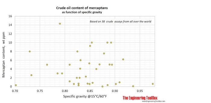

Sulfur, mercaptans
What:
Determination of mercaptan sulfur in typically gasolines, kerosines, aviation turbine fuels, and distillate fuels containing from 0.0003 to 0.01 mass % of mercaptan sulfur. Organic sulfur compounds such as sulfides, disulfides, and thiophene, do not interfere. Elemental sulfur in amounts less than 0.0005 mass % does not interfere. Hydrogen sulfide will interfere if not removed.
Why:
Mercaptan sulfur has an objectionable odor, an adverse effect on fuel system elastomers, and is corrosive to fuel system components.
How:
ASTM D3227 Standard Test Method for (Thiol Mercaptan) Sulfur in Gasoline, Kerosine, Aviation Turbine, and Distillate Fuels (Potentiometric Method):
The hydrogen sulfide-free sample is dissolved in an alcoholic sodium acetate titration solvent and titrated potentiometrically with silver nitrate solution, using as an indicator the potential between a glass reference electrode and a silver/ silver-sulfide indicating electrode. Under these conditions, the mercaptan sulfur is precipitated as silver mercaptide and the end point of the titration is shown by a large change in cell potential.
UOP163 Hydrogen Sulfide and Mercaptan Sulfur in Liquid Hydrocarbons by Potentiometric Titration:
The Liquid hydrocarbon sample is weighed into 2-propanol containing a small amount of ammonium hydroxide. The solution is titrated potentiometrically with alcoholic silver nitrate using a glass reference and silver-silver sulfide indicating electrode system. Hydrogen sulfide and mercaptane sulfur concentrations are calculated as mass ppm.
For determination of mercaptans in whole crude, the methods may need modification due to high viscosity of the crude.
Alternative test methods: IP 342, ISO 3012, JIS K 2276, ASTM D1323
Typical range of variation: 0 - 15 mg/kg mercaptans in crude oil
mercaptans_crude-oil

Sulfur, total
What:
A method covering the measurement of sulfur in hydrocarbons, such as diesel, naphtha, kerosine, jet fuels, crude oils, gasoline (all unleaded), and other distillates. In addition, sulfur in other products, such as M-85 and M-100, may be analyzed using this technique. The applicable concentration range is 0.0150 to 5.00 mass % sulfur.
Why:
The quality of many petroleum products is related to the amount of sulfur present. Knowledge of sulfur concentration is necessary for processing purposes. There are also regulations promulgated in federal, state, and local agencies that restrict the amount of sulfur present in some fuels. This test method provides a means of compliance with specifications or limits set by regulations for sulfur content of petroleum products. Compared to other test methods for sulfur determination,  D4294 has high throughput, minimal sample preparation, good precision, and is capable of determining sulfur over a wide range of concentrations. A typical analysis time is 2 to 4 min per sample.
How:
ASTMD4294 Standard Test Method for Sulfur in Petroleum and Petroleum Products by EnergyDispersive X-ray Fluorescence Spectrometry:
The sample is placed in the beam emitted from an X-ray source. The resultant excited characteristic X radiation is measured, and the accumulated count is compared with counts from previously prepared calibration standards that bracket the sample concentration range of interest to obtain the sulfur concentration in mass %.
Alternative test methods: ASTM D2622 and D5453, IP 336 and IP 373, ISO/DIS 14596
Typical range of variation: 0.002 - 4 wt% total sulfur in crude oil
Sulfur_total_crude

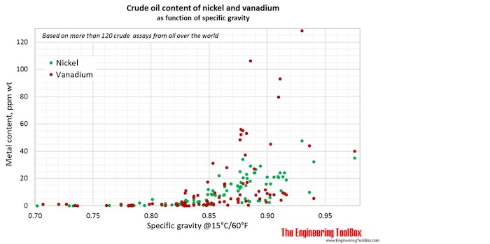

Trace metal
What:
Determination of nickel, vanadium, iron, sodium and other trace metals in crude oils and residual fuels
Why:
Ni and V are naturally present in the heavy part of crude oil. Corrosion products (iron) come from unlined tanks, piping, pumps, and heat exchangers . Sodium, calcium and other metals are present as salts solved in the small amounts of water following the crude, while silicon may be a part of defoamers used during production. Knowledge of trace elements in crude oil is important because they can have an adverse effect on petroleum refining and product quality. These effects can include catalyst poisoning in the refinery and excessive atmospheric emission in combustion of fuels. Trace element concentrations are also useful in correlating production from different wells and horizons in a field. Elements such as iron, arsenic, silicon and lead are catalyst poisons. Vanadium compounds can cause refractory damage in furnaces. Sodium compounds have been found to cause superficial fusion on fire brick, as well as salt build up causing corrosion and pressure drop in prosessing units. Some organometallic compounds are volatile which can lead to the contamination of distillate fractions, and a reduction in their stability or malfunctions of equipment when they are combusted.
How:
ASTM D5708 Standard Test Methods for Determination of Nickel, Vanadium, and Iron in Crude Oils and Residual Fuels by Inductively Coupled Plasma (ICP) Atomic Emission Spectrometry (AES)
Test Method A: ICP is used to analyze a sample dissolved in an organic solvent. This test method uses oil-soluble metals for calibration and does not purport to quantitatively determine or detect insoluble particulates.
Test Method B: ICP is used to analyze a sample that is decomposed with acid.
ASTM D5863 Standard Test Methods for Determination of Nickel, Vanadium, Iron, and Sodium in Crude Oils and Residual Fuels by Flame Atomic Absorption Spectrometry:
Test Method A: The oil sample are weighed into a beaker and decomposed with concentrated sulfuric acid by heating to dryness. The residual carbon is burned off by heating at 525°C in a muffle furnace. The inorganic residue is digested in dilute nitric acid, evaporated to incipient dryness, dissolved in dilute nitric and made up to volume with dilute nitric acid. Interference suppressant is added to the dilute nitric acid solution. The solution is nebulized into the flame of an atomic absorption spectrometer. A nitrous oxide/acetylene flame is used for vanadium and an air/acetylene flame is used for nickel and iron. The instrument is calibrated with matrix-matched standard solutions. The measured absorption intensities are related to concentrations by the appropriate use of calibration data.
Test Method B: Sample is diluted with an organic solvent to give a test solution containing either 5 % (m/m) or 20 % (m/m) sample. The recommended sample concentration is dependent on the concentrations of the analytes in the sample. For the determination of vanadium, interference suppressant is added to the test solution. The test solution is nebulized into the flame of an atomic absorption spectrometer. A nitrous oxide/acetylene flame is used for vanadium and an air/acetylene flame is used for nickel and sodium. The measured absorption intensities are related to concentrations by the appropriate use of calibration data.
ASTM D7691 Standard Test Method for Multielement Analysis of Crude Oils Using Inductively Coupled Plasma Atomic Emission Spectrometry (ICP-AES):
Inductively coupled plasma-atomic emission spectrometry  is a widely used technique in the oil industry. Its advantages over traditional atomic absorption spectrometry (AAS) include greater sensitivity, freedom from molecular interferences, wide dynamic range, and multi-element capability. For analysis of any element using wavelengths below 190 nm, a vacuum or inert gas optical path is required. Calibration, validation and operational guidance is given by standard ASTM D7260.
Ni: 0 - 50 ppm in crude oils
V: 0 - 150 ppm in crude oils
Fe: 0 - 50 ppm in crude oils
Ca: 0 - 150 ppm in crude oils
Crude oil metal (Ni, V) content as function of gravity

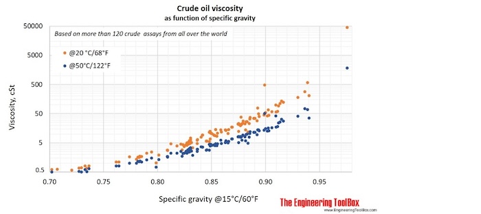

Viscosity
What:
Methods that specifies procedures for the determination of the kinematic and dynamic viscosity, n, of liquid petroleumproducts, both transparent and opaque. The methods are intended for application to liquids for which primarily the shear stress and shear rates are proportional (Newtonian flow behavior). The range of kinematic viscosities covered by this tese methods is from 0.2 mm2/s to 300 000 mm2/s  at all temperatures.
Why:
For crude oil production, viscosity is a major parameter to know for the choice of production methods. Also, for transportation and crude handling, the viscosity is important. Many petroleum products, and some non-petroleum materials, are used as lubricants, and the correct operation of the equipment depends upon the appropriate viscosity of the liquid being used. In addition, the viscosity of many petroleum fuels is important for the estimation of optimum storage, handling, and operational conditions. Thus, the accurate determination of viscosity is essential to many product specifications.
How:
ASTM D445 Standard Test Method for Kinematic Viscosity of Transparent and Opaque Liquids (and Calculation of Dynamic Viscosity):
The time is measured for a fixed volume of liquid to flow under gravity through the capillary of a calibrated viscometer under a reproducible driving head and at a closely controlled and known temperature. The kinematic viscosity (determined value) is the product of the measured flow time and the calibration constant of the viscometer. The dynamic viscosity, can be obtained by multiplying the kinematic viscosity by the density of the liquid.
ASTM D446 Standard Specifications and Operating Instructions for Glass Capillary Kinematic Viscometers
These specifications cover operating instructions for glass capillary kinematic viscometers, also some widely used viscometers suitable for use in accordance with Test Method D 445.
ASTM D7042 Standard Test Method for Dynamic Viscosity and Density of Liquids by Stabinger Viscometer (and the Calculation of Kinematic Viscosity)
The test specimen is introduced into the measuring cells, which are at a closely controlled and known temperature. The measuring cells consist of a pair of rotating concentric cylinders and an oscillating U-tube. The dynamic viscosity is determined from the equilibrium rotational speed of the inner cylinder under the influence of the shear stress of the test specimen and an eddy current brake in conjunction with adjustment data. The density is determined by the oscillation frequency of the U-tube in conjunction with adjustment data. The kinematic viscosity is calculated by dividing the dynamic viscosity by the density.
Alternative test methods: IP 71,  ISO 3104, JIS K2283
Viscosity@20°C (68°F):   0.5 - 1000 cSt
Viscosity@40°C (104°F):  0.5 - 130 cSt
Viscosity@50°C (122°F):   0.5 - 70 cSt
Crude oil viscosity gravity

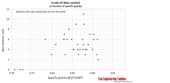

Wax content
What:
A method for estimating the paraffin wax content of petroleum oils and asphalts. Wax content is an empirical value dependent upon the conditions under which the wax is separated from the original material.
Why:
Wax deposition is one of the chronic problems in the petroleum industry. Paraffin waxes consist of straight chain saturated hydrocarbons with carbons atoms ranging from C20 to C50. Paraffin wax consists mostly with normal paraffin content (80–90%), while, the rest consists of branched paraffins (isoparaffins) and cycloparaffins. Waxes may precipitate as the temperature decreases and a solid phase may arise due to their low solubility. For instance, paraffinic waxes can precipitate out when temperature decreases during oil production, transportation through pipelines, and oil storage. The process of solvent dewaxing is used to remove wax from either distillate or residual feedstocks at any stage in the refining process.
How:
UOP46 Paraffin Wax Content of Petroleum Oils and Asphalts:
Paraffin wax content is defined as the mass-percent of material precipitated when a solution of asphalt-free sample in methylene chloride is cooled to -30 C. The lower limit of detection is 5 mass-percent.
Typical range of variation: 0 - 15 wt% of wax in crude oil
Wax in crude oil
