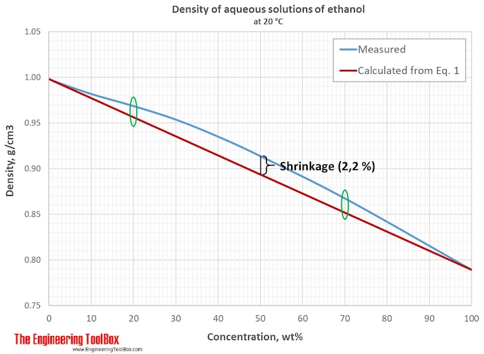

At 20°C, the density of water is 0.9982 g/cm3 and the density of pure ethanol is 0.7893 g/cm3 . For 20% ethanol, the density can be estimated using Eq [1]:
Density 20% ethanol = (80[%]*0.9982 [g/cm3 ]+ 20[%]*0.7893[g/cm3 ])/100[%] =  0.9564 [g/cm3 ]
The same calculation is done for 50 and 70 wt% of ethanol, and the results and the difference from measured values are shown in the table below.

In the figure below, it is seen that with ethanol concentrations < 20% and > 70%, the estimated values are closer to the measured values.
shrinkage

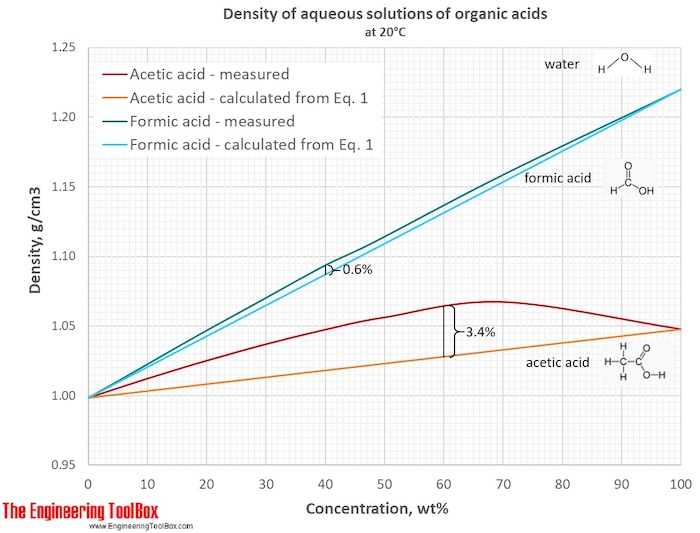

The figure below shows the shrinkage for aqueous solutions of formic and acetic acids. It illustrates that the shrinkage is largest when the difference in molecular size is largest.
shrinkage_acids
