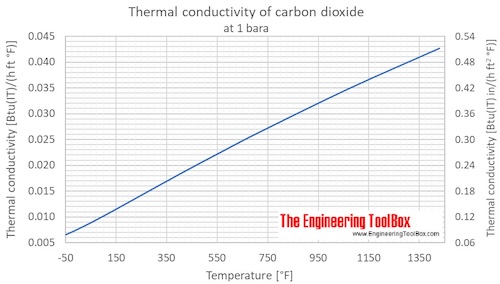

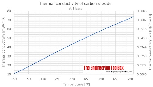

Thermal conductivity most common units are W/(m K) in the SI system and Btu/(h ft °F) in the Imperial system.
Tabulated values and thermal conductivity units conversion are given below the figures.
Online Carbon Dioxide Thermal Conductivity Calculator
The calculator below can be used to estimate the thermal conductivity of gaseous carbon dioxide at given temperatures and 1 bara.
The output conductivity is given as mW/(m K), Btu(IT)/(h ft °F), (Btu(IT) in)/(h ft2°F) and kcal(IT)/(h m K).

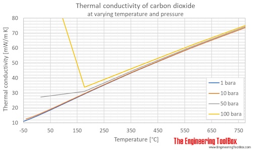

Thermal conductivity of carbon dioxide at given temperatures and pressures:
State | Temperature | Pressure | Thermal conductivity | |||||||
[K] | [°C] | [°F] | [MPa] | [bara] | [psia] | [mW/m K] | [kcal(IT)/(h m K)] | [Btu(IT)/(h ft °F)] | [Btu(IT) in/(h ft2 °F)] | |
