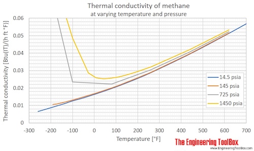

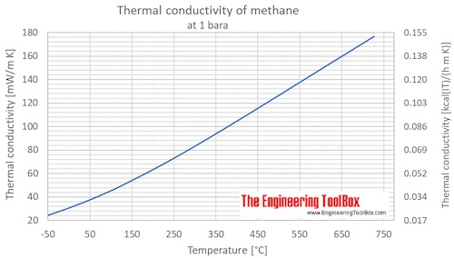

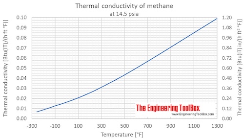

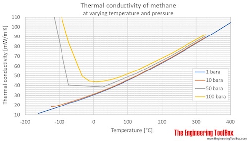

Methane - Thermal Conductivity vs. Temperature and Pressure
Online calculator, figures and table showing thermal conductivity of methane, CH4, at temperatures ranging from -160 to 725 °C (-260 to 1300 °F) at atmospheric and higher pressure - Imperial and SI Units.
Thermal conductivity is a material property that describes ability to conduct heat . Thermal conductivity can be defined as
" the quantity of heat transmitted through a unit thickness of a material - in a direction normal to a surface of unit area - due to a unit temperature gradient under steady state conditions".
Thermal conductivity most common units are W/(m K) in the SI system and Btu/(h ft °F) in the Imperial system.
Tabulated values and thermal conductivity units conversion are given below the figures.

Thermal conductivity of methane at given temperatures and pressures:
State | Temperature | Pressure | Thermal conductivity | |||||||
[K] | [°C] | [°F] | [MPa] | [bara] | [psia] | [mW/m K] | [kcal(IT)/(h m K)] | [Btu(IT)/(h ft °F)] | [Btu(IT) in/(h ft2 °F)] | |
Liquid | 100 | -173 | -280 | 0.1 | 1 | 14.5 | 199.7 | 0.1717 | 0.1154 | 1.385 |
111.5 | -161.6 | -259.0 | 0.1 | 1 | 14.5 | 184.1 | 0.1583 | 0.1064 | 1.276 | |
Gas | 111.5 | -161.6 | -259.0 | 0.1 | 1 | 14.5 | 11.43 | 0.009828 | 0.006604 | 0.07925 |
140 | -133 | -208 | 0.1 | 1 | 14.5 | 14.65 | 0.01260 | 0.008465 | 0.1016 | |
180 | -93.2 | -136 | 0.1 | 1 | 14.5 | 19.32 | 0.01661 | 0.01116 | 0.1340 | |
200 | -73.2 | -99.7 | 0.1 | 1 | 14.5 | 21.94 | 0.01887 | 0.01268 | 0.1521 | |
220 | -53.2 | -63.7 | 0.1 | 1 | 14.5 | 23.99 | 0.02063 | 0.01386 | 0.1663 | |
240 | -33.2 | -27.7 | 0.1 | 1 | 14.5 | 26.39 | 0.02269 | 0.01525 | 0.1830 | |
260 | -13.2 | 8.3 | 0.1 | 1 | 14.5 | 28.88 | 0.02483 | 0.01669 | 0.2002 | |
280 | 6.9 | 44.3 | 0.1 | 1 | 14.5 | 31.47 | 0.02706 | 0.01818 | 0.2182 | |
300 | 26.9 | 80.3 | 0.1 | 1 | 14.5 | 34.19 | 0.02940 | 0.01975 | 0.2371 | |
320 | 46.9 | 116 | 0.1 | 1 | 14.5 | 37.04 | 0.03185 | 0.02140 | 0.2568 | |
340 | 66.9 | 152 | 0.1 | 1 | 14.5 | 40.03 | 0.03442 | 0.02313 | 0.2775 | |
360 | 86.9 | 188 | 0.1 | 1 | 14.5 | 43.15 | 0.03710 | 0.02493 | 0.2992 | |
400 | 127 | 260 | 0.1 | 1 | 14.5 | 49.80 | 0.04282 | 0.02877 | 0.3453 | |
500 | 227 | 440 | 0.1 | 1 | 14.5 | 68.34 | 0.05876 | 0.03949 | 0.4738 | |
600 | 327 | 620 | 0.1 | 1 | 14.5 | 88.80 | 0.07635 | 0.05131 | 0.6157 | |
700 | 427 | 800 | 0.1 | 1 | 14.5 | 110.4 | 0.0949 | 0.06379 | 0.7655 | |
800 | 527 | 980 | 0.1 | 1 | 14.5 | 132.5 | 0.1139 | 0.07656 | 0.9187 | |
900 | 627 | 1160 | 0.1 | 1 | 14.5 | 154.7 | 0.1330 | 0.08938 | 1.073 | |
1000 | 727 | 1340 | 0.1 | 1 | 14.5 | 176.7 | 0.1519 | 0.10210 | 1.225 | |
Liquid | 100 | -173 | -280 | 1 | 10 | 145 | 200.6 | 0.1725 | 0.1159 | 1.391 |
149.1 | -124.0 | -191.2 | 1 | 10 | 145 | 130.7 | 0.1123 | 0.07549 | 0.9059 | |
Gas | 149.1 | -124.0 | -191.2 | 1 | 10 | 145 | 18.17 | 0.01562 | 0.01050 | 0.1260 |
160 | -113 | -172 | 1 | 10 | 145 | 18.79 | 0.01616 | 0.01086 | 0.1303 | |
180 | -93.2 | -136 | 1 | 10 | 145 | 20.65 | 0.01776 | 0.01193 | 0.1432 | |
200 | -73.2 | -99.7 | 1 | 10 | 145 | 22.74 | 0.01955 | 0.01314 | 0.1577 | |
220 | -53.2 | -63.7 | 1 | 10 | 145 | 24.90 | 0.02141 | 0.01439 | 0.1726 | |
240 | -33.2 | -27.7 | 1 | 10 | 145 | 27.19 | 0.02338 | 0.01571 | 0.1885 | |
260 | -13.2 | 8.3 | 1 | 10 | 145 | 29.60 | 0.02545 | 0.01710 | 0.2052 | |
280 | 6.9 | 44.3 | 1 | 10 | 145 | 32.12 | 0.02762 | 0.01856 | 0.2227 | |
300 | 26.9 | 80.3 | 1 | 10 | 145 | 34.79 | 0.02991 | 0.02010 | 0.2412 | |
320 | 46.9 | 116 | 1 | 10 | 145 | 37.59 | 0.03232 | 0.02172 | 0.2606 | |
340 | 66.9 | 152 | 1 | 10 | 145 | 40.54 | 0.03486 | 0.02342 | 0.2811 | |
360 | 86.9 | 188 | 1 | 10 | 145 | 43.64 | 0.03752 | 0.02521 | 0.3026 | |
400 | 127 | 260 | 1 | 10 | 145 | 50.23 | 0.04319 | 0.02902 | 0.3483 | |
500 | 227 | 440 | 1 | 10 | 145 | 68.68 | 0.05905 | 0.03968 | 0.4762 | |
600 | 327 | 620 | 1 | 10 | 145 | 89.08 | 0.07660 | 0.05147 | 0.6176 | |
Liquid | 100 | -173 | -280 | 5 | 50 | 725 | 204.5 | 0.1758 | 0.1181 | 1.418 |
Supercritical phase |
200 | -73.2 | -99.7 | 5 | 50 | 725 | 40.61 | 0.03492 | 0.02347 | 0.2816 |
300 | 26.9 | 80.3 | 5 | 50 | 725 | 38.48 | 0.03309 | 0.02223 | 0.2668 | |
400 | 127 | 260 | 5 | 50 | 725 | 52.69 | 0.04531 | 0.03045 | 0.3653 | |
500 | 227 | 440 | 5 | 50 | 725 | 70.51 | 0.06063 | 0.04074 | 0.4889 | |
600 | 327 | 620 | 5 | 50 | 725 | 90.50 | 0.07781 | 0.05229 | 0.6275 | |
Liquid | 100 | -173 | -280 | 10 | 100 | 1450 | 209.1 | 0.1798 | 0.1208 | 1.450 |
200 | -73.2 | -100 | 10 | 100 | 1450 | 84.23 | 0.07243 | 0.04867 | 0.5840 |
240 | -33.2 | -27.7 | 10 | 100 | 1450 | 49.74 | 0.04277 | 0.02874 | 0.3449 | |
260 | -13.2 | 8.3 | 10 | 100 | 1450 | 44.85 | 0.03856 | 0.02591 | 0.3110 | |
280 | 6.9 | 44.3 | 10 | 100 | 1450 | 43.81 | 0.03767 | 0.02531 | 0.3038 | |
300 | 26.9 | 80.3 | 10 | 100 | 1450 | 44.37 | 0.03815 | 0.02564 | 0.3076 | |
320 | 46.9 | 116 | 10 | 100 | 1450 | 45.79 | 0.03937 | 0.02646 | 0.3175 | |
340 | 66.9 | 152 | 10 | 100 | 1450 | 47.75 | 0.04106 | 0.02759 | 0.3311 | |
360 | 86.9 | 188 | 10 | 100 | 1450 | 50.09 | 0.04307 | 0.02894 | 0.3473 | |
400 | 127 | 260 | 10 | 100 | 1450 | 55.61 | 0.04782 | 0.03213 | 0.3856 | |
500 | 227 | 440 | 10 | 100 | 1450 | 72.78 | 0.06258 | 0.04205 | 0.5046 | |
200 | -73.2 | -100 | 100 | 1000 | 14500 | 188.1 | 0.1617 | 0.1087 | 1.304 |
300 | 26.9 | 80.3 | 100 | 1000 | 14500 | 137.7 | 0.1184 | 0.07955 | 0.9546 | |
400 | 127 | 260 | 100 | 1000 | 14500 | 120.4 | 0.1035 | 0.06955 | 0.8347 | |
500 | 227 | 440 | 100 | 1000 | 14500 | 120.9 | 0.1039 | 0.06984 | 0.8381 | |
600 | 327 | 620 | 100 | 1000 | 14500 | 130.4 | 0.1121 | 0.07532 | 0.9039 |
