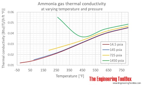

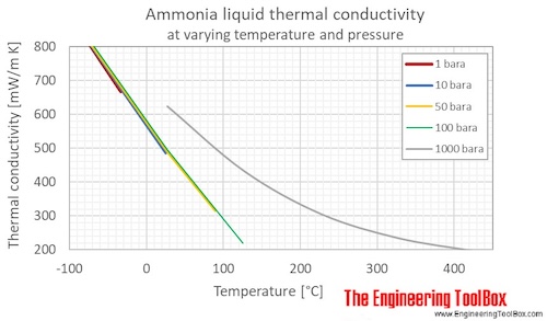

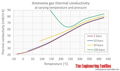

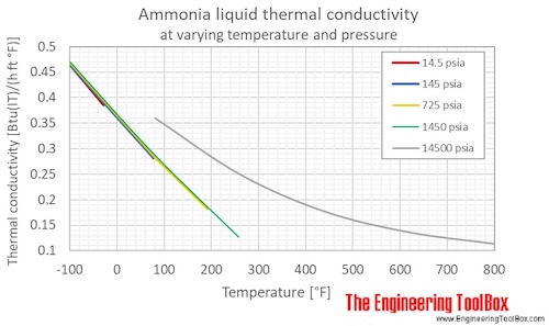

Ammonia thermal conductivity at given temperatures and pressures:
State | Temperature | Pressure | Thermal conductivity | ||||||
[K] | [°C] | [°F] | [MPa] | [bara] | [psia] | [mW/m K] | [kcal(IT)/(h m K)] | [Btu(IT)/(h ft °F)] | |
Liquid | 200 | -73.2 | -99.7 | 0.1 | 1 | 15 | 803.2 | 0.6907 | 0.4641 |
239.56 | -33.6 | -28.5 | 0.1 | 1 | 15 | 666.6 | 0.5731 | 0.3851 | |
Gas | 239.56 | -33.6 | -28.5 | 0.1 | 1 | 15 | 20.96 | 0.01802 | 0.01211 |
300 | 26.9 | 80.3 | 0.1 | 1 | 15 | 25.10 | 0.02158 | 0.01450 | |
400 | 126.9 | 260.3 | 0.1 | 1 | 15 | 37.22 | 0.03200 | 0.02150 | |
500 | 226.9 | 440.3 | 0.1 | 1 | 15 | 53.12 | 0.04567 | 0.03069 | |
600 | 326.9 | 620.3 | 0.1 | 1 | 15 | 68.61 | 0.05899 | 0.03964 | |
700 | 426.9 | 800.3 | 0.1 | 1 | 15 | 78.31 | 0.06734 | 0.04525 | |
Liquid | 200 | -73.2 | -99.7 | 1 | 10 | 145 | 804.2 | 0.6915 | 0.4647 |
298.05 | 24.9 | 76.8 | 1 | 10 | 145 | 485.8 | 0.4177 | 0.2807 | |
Gas | 298.05 | 24.9 | 76.8 | 1 | 10 | 145 | 26.15 | 0.02248 | 0.01511 |
300 | 26.9 | 80.3 | 1 | 10 | 145 | 26.31 | 0.02262 | 0.01520 | |
400 | 126.9 | 260.3 | 1 | 10 | 145 | 38.09 | 0.03275 | 0.02201 | |
500 | 226.9 | 440.3 | 1 | 10 | 145 | 53.75 | 0.04622 | 0.03106 | |
600 | 326.9 | 620.3 | 1 | 10 | 145 | 69.12 | 0.05944 | 0.03994 | |
700 | 426.9 | 800.3 | 1 | 10 | 145 | 78.75 | 0.06771 | 0.04550 | |
Liquid | 200 | -73.2 | -99.7 | 5 | 50 | 725 | 808.6 | 0.6953 | 0.4672 |
300 | 26.9 | 80.3 | 5 | 50 | 725 | 487.6 | 0.4192 | 0.2817 | |
362.03 | 88.9 | 192.0 | 5 | 50 | 725 | 313.9 | 0.2699 | 0.1814 | |
Gas | 362.03 | 88.9 | 192.0 | 5 | 50 | 725 | 41.69 | 0.03585 | 0.02409 |
400 | 126.9 | 260.3 | 5 | 50 | 725 | 45.73 | 0.03932 | 0.02642 | |
500 | 226.9 | 440.3 | 5 | 50 | 725 | 57.29 | 0.04926 | 0.03310 | |
600 | 326.9 | 620.3 | 5 | 50 | 725 | 71.79 | 0.06173 | 0.04148 | |
700 | 426.9 | 800.3 | 5 | 50 | 725 | 80.94 | 0.06960 | 0.04677 | |
Liquid | 200 | -73.2 | -99.7 | 10 | 100 | 1450 | 814.0 | 0.6999 | 0.4703 |
300 | 26.9 | 80.3 | 10 | 100 | 1450 | 496.5 | 0.4269 | 0.2869 | |
398.32 | 125.2 | 257.3 | 10 | 100 | 1450 | 218.7 | 0.1881 | 0.1264 | |
Gas | 398.32 | 125.2 | 257.3 | 10 | 100 | 1450 | 101.0 | 0.08688 | 0.05838 |
400 | 126.9 | 260.3 | 10 | 100 | 1450 | 95.5 | 0.08208 | 0.05515 | |
500 | 226.9 | 440.3 | 10 | 100 | 1450 | 63.9 | 0.05496 | 0.03693 | |
600 | 326.9 | 620.3 | 10 | 100 | 1450 | 76.1 | 0.06539 | 0.04394 | |
700 | 426.9 | 800.3 | 10 | 100 | 1450 | 84.2 | 0.07243 | 0.04867 | |
Liquid | 300 | 26.9 | 80.3 | 100 | 1000 | 14504 | 622.9 | 0.5356 | 0.3599 |
400 | 126.9 | 260.3 | 100 | 1000 | 14504 | 432.0 | 0.3714 | 0.2496 | |
500 | 226.9 | 440.3 | 100 | 1000 | 14504 | 305.7 | 0.2628 | 0.1766 | |
600 | 326.9 | 620.3 | 100 | 1000 | 14504 | 234.8 | 0.2019 | 0.1357 | |
700 | 426.9 | 800.3 | 100 | 1000 | 14504 | 196.0 | 0.1686 | 0.1133 | |
300 | 26.9 | 80.3 | 500 | 5000 | 72519 | 989.0 | 0.8504 | 0.5714 | |
400 | 126.9 | 260.3 | 500 | 5000 | 72519 | 804.1 | 0.6914 | 0.4646 | |
500 | 226.9 | 440.3 | 500 | 5000 | 72519 | 674.0 | 0.5795 | 0.3894 | |
600 | 326.9 | 620.3 | 500 | 5000 | 72519 | 582.6 | 0.5010 | 0.3366 | |
700 | 426.9 | 800.3 | 500 | 5000 | 72519 | 511.6 | 0.4399 | 0.2956 | |
300 | 26.9 | 80.3 | 1000 | 10000 | 145038 | 1324 | 1.1384 | 0.7650 | |
400 | 126.9 | 260.3 | 1000 | 10000 | 145038 | 1139 | 0.9793 | 0.6580 | |
500 | 226.9 | 440.3 | 1000 | 10000 | 145038 | 996.5 | 0.8568 | 0.5758 | |
600 | 326.9 | 620.3 | 1000 | 10000 | 145038 | 887.7 | 0.7633 | 0.5129 | |
700 | 426.9 | 800.3 | 1000 | 10000 | 145038 | 797.3 | 0.6855 | 0.4606 |
