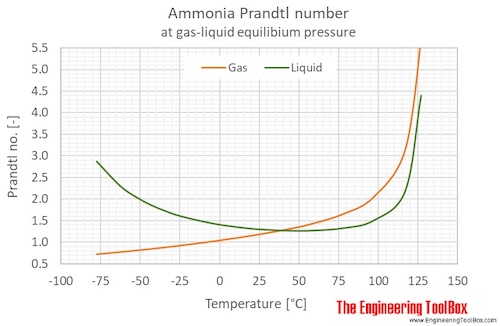

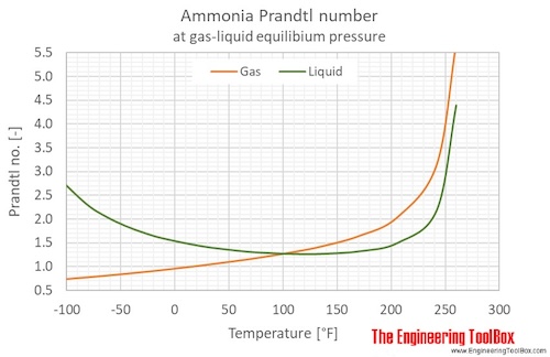

Ammonia Prandtl number at gas-liquid equilibrium pressure, temperature given as °C or °F:

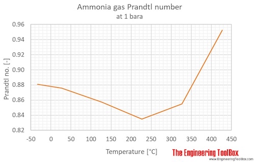

Ammonia Prandtl number at atmospheric pressure, temperature given as °C:

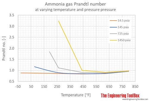

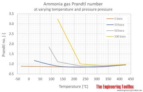

Ammonia Prandtl number at varying temperatures at given constant pressures, SI and Imperial units:
