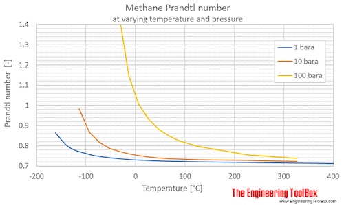

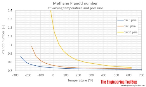

Below, Prandtl numbers for methane at varying temperatures and pressures are given in figures and table .
See also other properties of Methane at varying temperature and pressure : Density and specific weight , Dynamic and kinematic viscosity , Specific heat (Heat capacity) and Thermal conductivity , and Thermophysical properties at standard conditions , as well as Prandtl number of Air , Ammonia , Carbon dioxide , Nitrogen , Propane and Water .

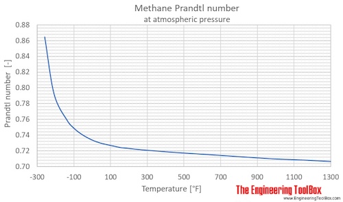

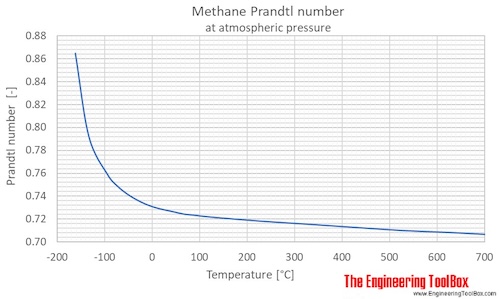

Methane Prandtl number at atmospheric pressure, temperature given as °C or °F:
Methane Prandtl number at varying temperatures and constant pressures, SI and Imperial units:
Methane Prandtl number at given temperatures and 1, 10 and 100 bara presure:
