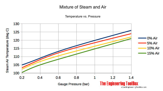

Mixing Air and Steam - Result Temperature
Mixing Air and Steam - Resulting Temperatures
Mixture Pressure0% Air
(Pure Steam)
5% Air10% Air15% Air
(psig)(bar)(oF)(oC)(oF)(oC)(oF)(oC)(oF)(oC)
2 0.15 219 104 216 102 213 101 210 99
5 0.35 227 108 225 107 222 106 219 104
10 0.7 239 115 237 114 233 112 230 110
20 1.4 259 126 256 124 252 122 249 121
Steam and air mixture - temperature
