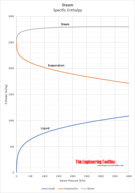

Steam - Enthalpy steam, evaporation and liquid vs. pressure chart
Steam evaporators used in industrial and waste water applications operates with pressures lower that the atmospheric pressure. In steam distribution system the pressure is almost always more than 0 bar gauge.

At 7 bar g (absolute 8 bar) the saturation temperature of water is 170.42 oC. More heat energy is required to raise its temperature to saturation point at 7 bar g than needed when the water is at atmospheric pressure. According the table 720.94 kJ is required to raise 1 kg of water from 0 oC to saturation temperature 170 oC.
The heat energy (enthalpy of evaporation) needed at 7 bar g to vaporize the water to steam is actually less than required at atmospheric pressure. The specific enthalpy of vaporization decreases with steam pressure. The evaporation heat is 2046.53 kJ/kg at 7 bar g.
  • Note! The specific volume of steam decreases with increased pressure - and the amount of heat energy distributed by the same volume increase. With higher pressure - more energy can be transferred in a steam distribution system.
