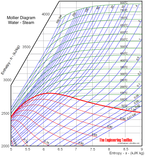

Water-Steam Mollier Diagram
Enthalpy-entropy diagram for water and steam.
The diagram below can be used to determine enthalpy versus entropy of water and steam.
Water - Mollier diagram
Download and print Mollier Diagram for Water - Steam
The Mollier diagram is useful when analyzing the performance of adiabatic steady-flow processes, such as flow in nozzles, diffusers, turbines and compressors.
See also Water - Enthalpy (H) and Entropy (S) for figures and tabulated values at varying temperatures
Dryness Fraction
The quantity of saturated vapor in unit mass of wet vapor , denoted by x , is referred to as the
dryness fraction , or quality,
of the vapor.

Example - Enthalpy
The enthalpy in saturated steam ( x = 1, the bold red line in the diagram) with pressure 10 bar can be estimated to aprox.
2770 kJ/kg
The value can be verified by using the steam table .
