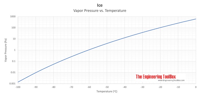

Vapour Pressure Ice
Ice - Vapour Pressure
Temperature
(oC)
-220 -200 -150 -100 -90 -80 -70 -60 -50 -40 -30 -20 -10 -5 -0.01
Vapour Pressure
(Pa abs)
2.06×10-37 3.31×10-24 9×10-10 0.0014 0.0097 0.055 0.261 1.08 3.94 12.84 38 103.2 259.9 401.7 611.7
Vapor Pressure Ice
Download and print Ice - Vapor Pressure vs. Temperature chart
