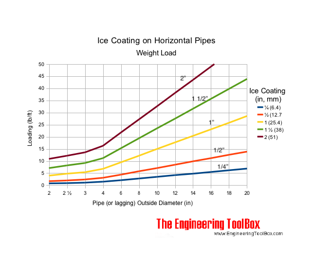

Ice Loaded Pipelines
Ice coat weight on horizontal pipe lines.
Weight load on ice coated horizontal pipe lines:
ice coatings horizontal pipelines
  • 1 lb/ft = 1.49 kg/m
