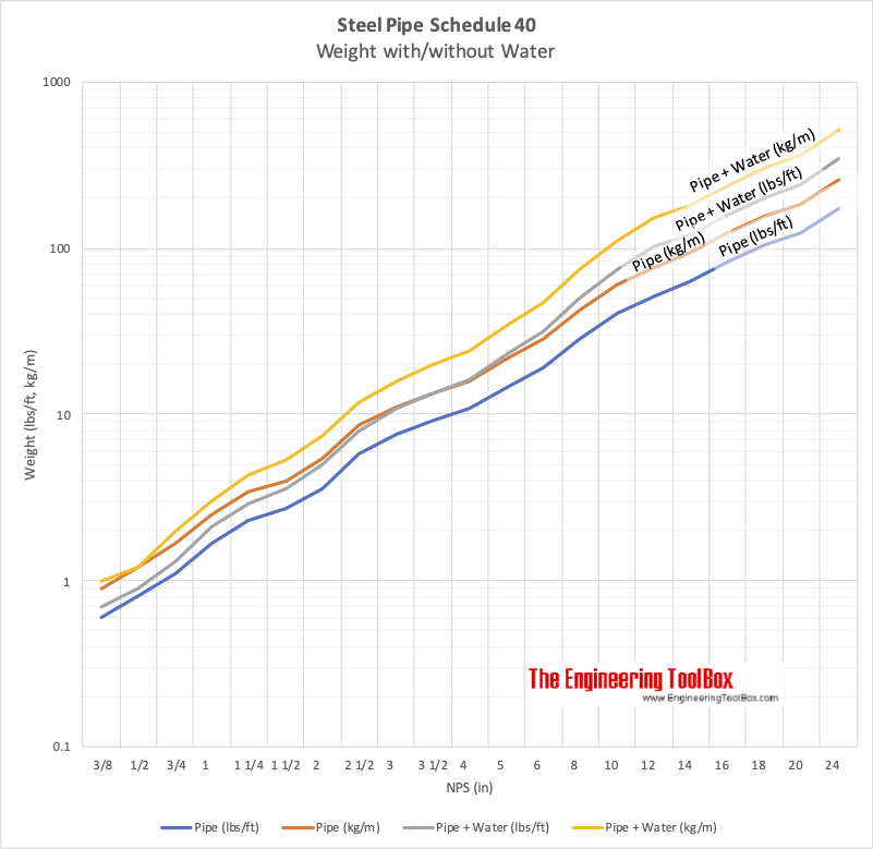

Typical Weight of Schedule 40 Steel Pipe with/without Water
Nominal Pipe SizeWeight of PipeWeight of Pipe filled with Water
(in)(mm)(lbs/ft)(kg/m)(lbs/ft)(kg/m)
3/8 10 0.6 0.9 0.7 1.0
1/2 15 0.8 1.2 0.9 1.2
3/4 20 1.1 1.7 1.3 2.0
1 25 1.7 2.5 2.1 3.0
1 1/4 32 2.3 3.4 2.9 4.3
1 1/2 40 2.7 4.0 3.6 5.3
2 50 3.6 5.4 5.0 7.5
2 1/2 65 5.8 8.6 7.9 11.7
3 80 7.6 11.2 10.8 15.9
3 1/2 90 9.1 13.5 13.4 19.8
4 100 10.8 16.0 16.3 24.2
5 125 14.6 21.7 23.2 34.6
6 150 19.0 28.2 31.5 46.8
8 200 28.5 42.5 50.1 74.6
10 250 40.5 60.2 74.6 111
12 300 51.1 75.9 102 152
14 350 63.0 93.7 122 181
16 400 83.0 124 160 237
18 450 105 156 202 301
20 500 123 183 243 362
24 600 171 255 345 514
Steel pipe schedule 40 - weight with without water
