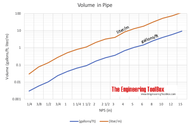

Volume in pipe
The volume weight for other liquids can be calculated when compensated for density.
