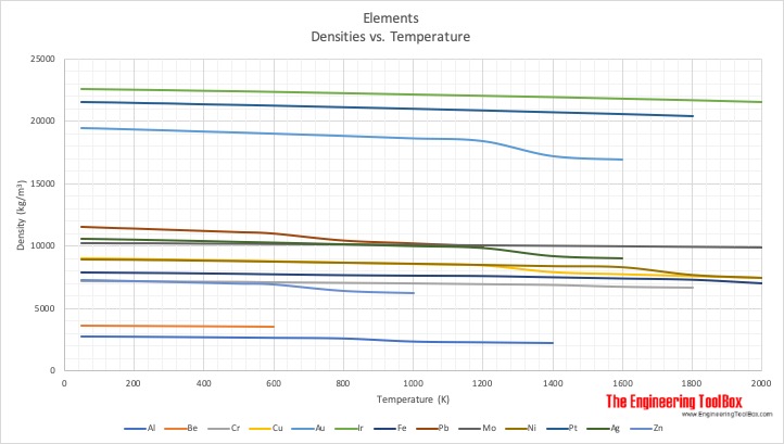

Elements - Densities vs. Temperature
Densities of
- Al - Aluminum
- Be - Beryllium
- Cr - Chromium
- Cu - Copper
- Au - Gold
- Ir - Iridium
- Fe - Iron
- Pb - Lead
- Mo - Molybdenum
- Ni - Nickel
- Pt - Platinum
- Ag - Silver
- Zn - Zinc
vs. temperature are indicated in the chart below.
