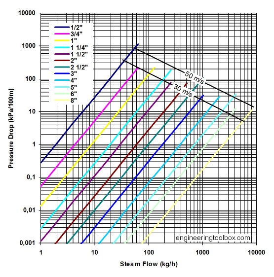

Pressure Drop Diagrams - metric units
The diagrams below can be used to indicate pressure drop in steam pipes at different pressures. The calculations are made for schedule 40 pipe.
  • 1 bar = 100 kPa = 10,197 kp/m2 = 10.20 m H2O = 0.9869 atm = 14.50 psi (lbf/in2)
  • 1 kg/h = 2.778x10-4 kg/s = 3.67x10-2 lb/min
Steam - pressure 1 bar gauge
Steam pipe pressure drop - steam pressure 1 bar

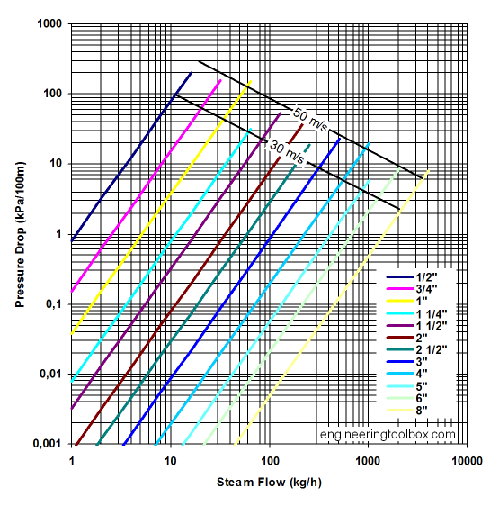

Steam - pressure 3 bar gauge
Steam pipe pressure drop - steam pressure 3 bar

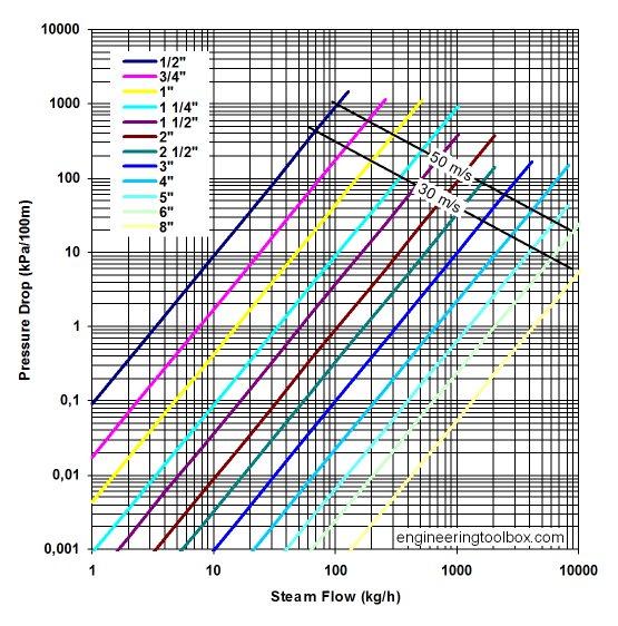

Steam - pressure 7 bar gauge
Steam pipe pressure drop - steam pressure 7 bar

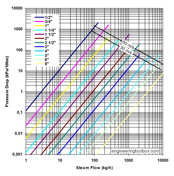

Steam - pressure 10 bar gauge
Steam pipe pressure drop - steam pressure 10 bar
