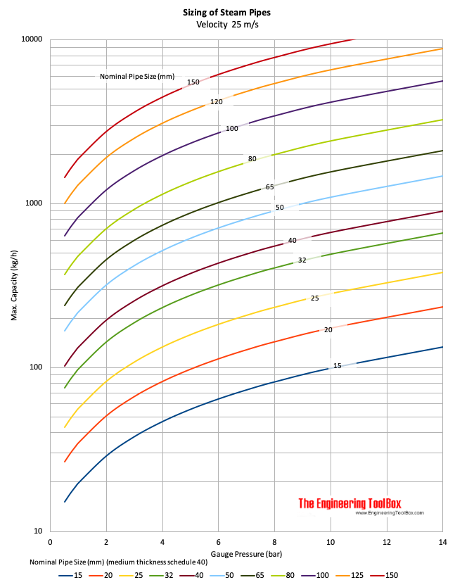

Steam is a compressible gas where pipe line mass flow capacity depends on steam pressure.
Steam is a compressible gas where mass flow capacity of pipe lines depends on steam pressures. Steam pipes can be sized with the table and diagram below - pressure in bar, velocity in m/s and capacity in kg/h.
Steam velocities of 25 m/s are in general sufficient for most saturated steam applications.

The values above are calculated for steel pipes medium thickness schedule 40. Using other standards with different inside diameters, the values above should be compensated.
Example - Capacity of 50 mm Steam Pipe
The capacity of a 50 mm steam pipe with 10 bar pressure and steam velocity 25 m/s is 1098 kg/h.
