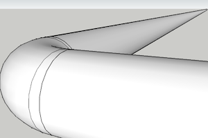

Example - Expansion of Steam Pipe
Steel pipe - temperature expansion
A system is designed for pressure 10 bar with operating temperature approximately 180 oC. As indicated in the table above (177 oC) the expansion is is approximately 203 mm100m pipe.
The expansion of a 35 m long pipe can be calculated as
dl = ((203 mm100m) / (100 m)) (35 m)
    = 71 mm
