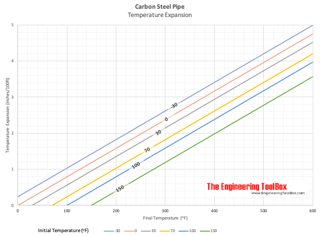

Carbon Steel Pipes - Temperature Expansion - Fahrenheit
The temperature expansion of carbon steel pipes expressed in inches per 100 feet per degree Fahrenheit:
Steel pipes - temperature expansion diagram - in fahrenheit

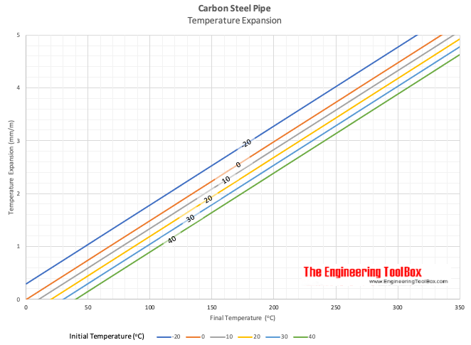

Carbon Steel Pipes - Temperature Expansion - Celcius
The temperature expansion of carbon steel pipes expressed in mm per m per degree Celsius:
Steel pipes - temperature expansion - in celcius
Example - Expansion of Steam Pipe
The expansion of 10 m steam pipe from an installation temperature of 20 oC to design temperature 180 oC (pressure 10 bar) is 2.4 mm/m or
10 (m) 2.4 (mm/m) = 24 mm
