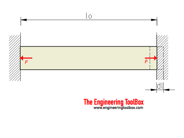

Axial Force
The axial force acted by the restricted bar due to change in temperature can be expressed as
F = σdt
   = E α dt A                                  (5)
F = axial force (N)
A = cross-sectional area of bar (m2, in2)

If the expansion of the pipe is restricted - the stress created due to the temperature change can be calculated as
σdt(200 109 N/m2) (12 10-6 m/mK) ((90oC) - (20oC))
     = 168 106 N/m2 (Pa)
     = 168 MPa
Note! - if there is pressure in the pipe - the axial and circumferential (hoop) stress may be added to restricted temperature expansion stress by using vector addition.
The outside diameter of the pipe is 168.275 mm (6.63 in) and the wall thickness is 7.112 mm (0.28 in). The cross-sectional area of the pipe wall can then be calculated to
A = π ((168.275 mm) / 2)2 - π ((168.275 mm) - 2 (7.112 mm)) / 2)2
   = 3598 mm2
   = 3.6 10-3 m2
The force acting at the ends of the pipe when it is restricted can be calculated as
F = (168 106 N/m2) (3.6 10-3 m2)
   = 604800 N
   = 604 kN
