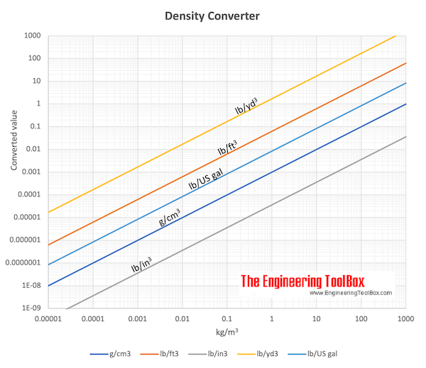

Density converting chart
Download and print density converting chart
