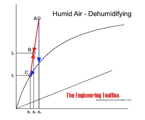

1. Cooling the air - vapor condensation
In a cooling system humidity is reduced by cooling the air below the dew point. A part of the moisture in the air is condensed and drained out.
The cooling and dehumidification process in Mollier diagram:
Mollier diagram - cooling and dehumidification
