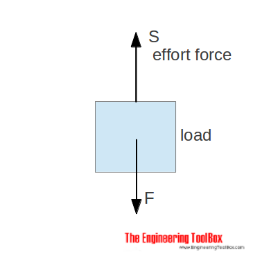

Without Pulley
Dulley - force without pulley
With no pulley - the effort force is similar to the load - in opposite direction.
S = F                                  (1)

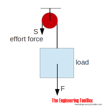

Fixed Pulley
Pulley - force with single fixed pulley
With a single fixed pulley the effort force is similar (or more due to efficiency loss) to the load.
S = F                                (2)
The advantage with the single fixed pulley is that the direction of force is changed - it is possible to pull down instead of lifting up.

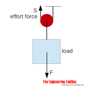

Movable Pulley
Pulley - force with single movable pulley
With a single moveable pulley the effort force is half (or more due to efficiency loss) of the load.
S = 1/2 F                                (3)

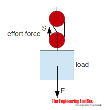

Pulley - force with  combined pulley
With two pulleys and the ropes as above - the effort force is 1/3 (or more due to efficiency) of the load.
S = 1/3 F                             (5)
