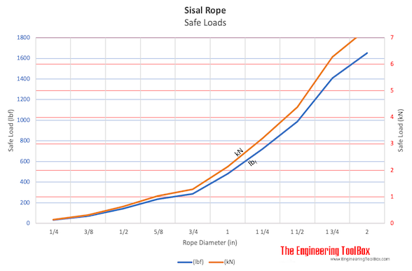

Sisal rope - safe loads (lbf, kN)
Download and print Sisal Rope Safe Load Chart
