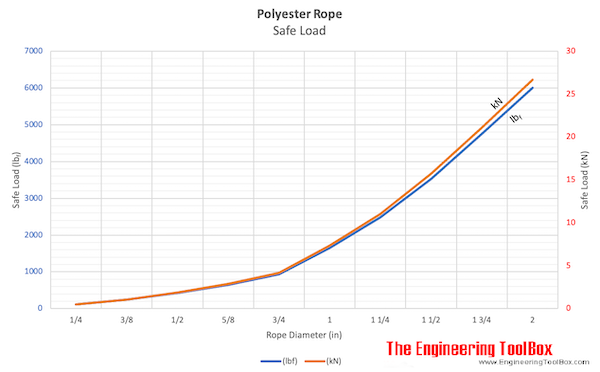

Polyester Rope Safe Load Chart
Polyester rope - safe load chart
Download and print Polyester Rope Safe Load Chart
