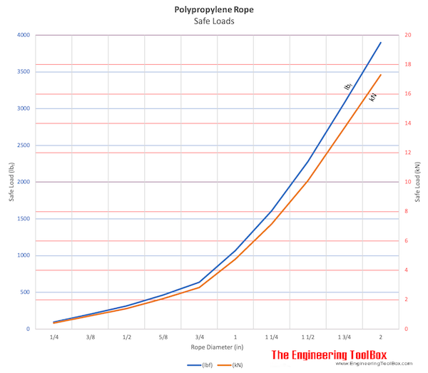

Polypropylene Rope Safe Loads Chart
Download Polypropylene Rope Safe Loads Chart
