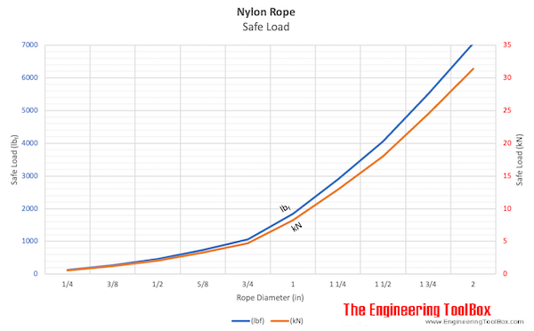

Nylon Rope - Safe Loads
Download and print Nylon Rope Safe Load Chart
