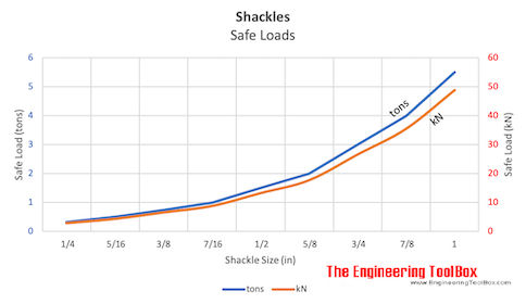

Safe loads of shackles.
shackle safe load
Safe load shackles:
Shackles - Safe Loads
Size
(in)
Safe Load
(tons)
1/4 1/3
5/16 1/2
3/8 3/4
7/16 1
1/2 1 1/2
5/8 2
3/4 3
7/8 4
1 5 1/2
  • check with the manufacturer for exact data
  • 1 in = 25.4 mm
  • 1 ton = 2000 lbs = 907 kg
Shackles safe loads (tons, kN)
