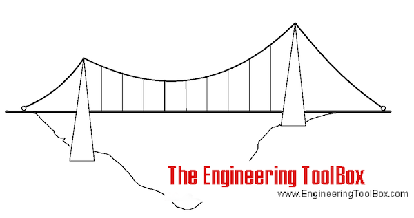

Force and tension in cables with uniform loads.
cable bridge
The equations below can also be used for cables only loaded with their own weight as long as the sagging height (h) vs. length (L) ratio is below 0.1.

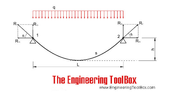

Uniformly Loaded Cables with Horizontal Loads
Uniformly loaded cable with horizontal chords
The cable follows the shape of a parable and the horizontal support forces can be calculated as
R1x = R2x
      = q L2 / (8 h)                               (1)
R1x = R2x = horizontal support forces (lb, N) (equal to midspan lowest point tension in cable)
q = unit load (weight) on the cable (lb/ft, N/m)
L = cable span (ft, m)
h = cable sag (ft, m)
The vertical support forces at the end of the cable can be calculated as
R1y = R2y
      = q L / 2                               (1a)
R1y = R2y = vertical support forces  (lb, N)
The resultant forces acting in the end supports - and in the direction of the cable close to the supports - can be calculated as
R1 = R2
     = (R1x2 + R1y2)0.5
     = (R2x2 + R2y2)0.5                               (1b)
R1,2 = resultant force at the support (lb, N)
The angle θ can be calculated as
θ = tan-1(R1y / R1x)
   = tan-1(R2y / R2x)           (1c)
The length of the sagged cable can be approximated to
s = L + 8 h2 / (3 L)                                 (1d)
s = cable length (ft, m)
Note that the equation is not valid when h > L / 4.

Example - Uniform Cable Load, Imperial units
A cable with length 100 ft and a sag 30 ft has a uniform load 850 lb/ft. The horizontal supports and mid-span cable forces can be calculated as
R1x = R2x
     = (850 lb/ft) (100 ft)2 / (8 (30 ft))
     = 35417 lb
The vertical forces at the supports can be calculated as
R1y = R2y
      = (850 lb/ft) (100 ft) / 2
      =  42500 lb
The resultant forces acting in the supports can be calculated as
R1,2 = ((35417 lb)2 + (42500 lb)2)0.5
      = 55323 lb
θ = tan-1((42500 lb) / (35417 lb))
           = 50.2 o
s = (100 ft) + 8 (30 ft)2 / (3 (100 ft))
   = 124 ft
Example - Uniform Cable Load, SI units
A cable with length 30 m and a sag 10 m has a uniform load of 4 kN/m. The horizontal supports and mid-span cable forces can be calculated as
R1x = R2x
      = (4000 N/m) (30 m)2 / (8 (10 m))
      = 45000 N
      = 45 kN
The vertical support forces can be calculated as
R1y = R2y
      = (4000 N/m) (30 m) / 2
              =  60000 N
              = 60 kN
θ = tan-1((60 kN) / (45 kN))
           = 53.1 o
The resultant force acting in the supports can be calculated as
R1,2 = ((45000 N)2 + (60000 N)2)0.5
           = 75000 N
           = 75 kN
s = (30 m) + 8 (10 m)2 / (3 (30 m))
   = 38.9 m
Example - Known Tension at the Supports - Calculate Sagging and Length of Cable
For a 30 m long cable with uniform load 4 kN/m the resulting tension in the cable at the end supports are 100 kN.
The vertical forces in the supports can be calculated as
R1y = R2y
      = (4 kN/m) (30 m) / 2
              = 60 kN
The horizontal forces in the supports can be calculated as
R1x = R2x
      = ((100 kN)2 - (60 kN)2)0.5
               = 80 kN
θ = tan-1((60 kN) / (80 kN))
           = 36.9 o
The sagging can be calculated by modifying eq.1 to
h = q L2 / (8 R1x)
           = (4 kN/m) (30 m)2 / (8 (80 kN))
           = 5.6 m
The length of the sagged cable can be estimated to
s = (30 m) + 8 (5.6 m)2 / (3 (30 m))
   = 32.8 m

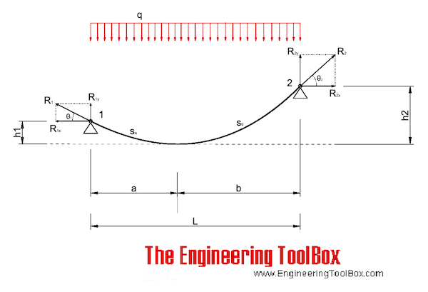

Uniformly Loaded Cables with Inclined Chords
Uniformly loaded cable with inclined chords
Inclined Cable Calculator - with Uniform Horizontal Loads
The calculator below can be used for cables with inclined chords and uniformly loads. The calculator is based on an iterative algorithm where the parable shaped cable is adapted to span L, height h1 and h2 according the figure above. The parable equation estimated below can be used to replicate the shape in spreadsheets or CAD systems.
inputs
canvas
results
The horizontal support forces in x-direction can be calculated as
R1x = R2x
      = q a2 / (2 h1)
      = q b2 / (2 h2)                            (2a)
If b > a the maximum forces in the cable and at support 1 and 2 can be calculated as
R2 = (R2x2 + (q b)2)0.5                   (2c)
R1 = (R1x2 + (q a)2)0.5                   (2d)
 - and the vertical forces at support 1 and 2 can be calculated as
R2y = (R22 - R2x2)0.5                    (2e)
R1y = (R12 - R1x2)0.5                    (2f)
The angles between the horizontal and resulting forces can be calculated as
θ2 = cos-1(R2x / R2)                    (2g)
θ1 = cos-1(R1x / R1)                   (2g)
The length of the sagged cable can be estimated as
sb = b (1 + 2/3 (h2 / b)2)             (2h)
sa = a (1 + 2/3 (h1 / a)2)             (2i)
s = sa + sb                                (2j)
Example - Inclined Cable with Uniform Load, SI units
A cable with span 30 m, length a = 7.2 m, length b = 22.8 m, sag h1= 1 m and sag h2 = 10 m has a uniform load of 4 kN/m.
The horizontal support forces can be calculated as
R1x = R2x
      = (4 kN/m) (30 m)2 / (2 (((1 m))0.5 + ((10 m))0.5))
      = 104 kN
The resulting support forces can be calculated as
R2 = ((103.9 kN)2 + ((4 kN/m) (22.8 m))2)0.5
     = 138 kN
R1 = ((103.9 kN)2 + ((4 kN/m) (7.2 m))2)0.5
    = 108 kN
R2y = ((138.2 kN)2 - (103.9 kN)2)0.5
      =  91.2 kN
R1y = ((107.8 kN)2 - (103.9 kN)2)0.5
      = 28.8 kN
The angles between resulting and horizontal forces in support 1 and 2 can be calculated as
θ2 = cos-1((103.9 kN)/ (138.2 kN))
    = 41.3 o
θ1 = cos-1((103.9 kN)/ (107.8 kN))
    = 15.5 o
The length of the sagged cable can be calculated as
sb = (22.8 m) (1 + 2/3 ((10 m) / (22.8 m))2
    = 25.7 m
sa =  (7.2 m) (1 + 2/3 ((1 m) / (7.2 m))2)
    = 7.3 m
s = (7.3 m) + (25.7 m )
  = 33 m
