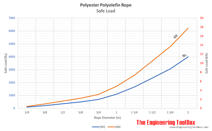

Polyester polyolefin rope - safe load chart
Download and print Polyester Polyolefin Rope Safe Load Chart
