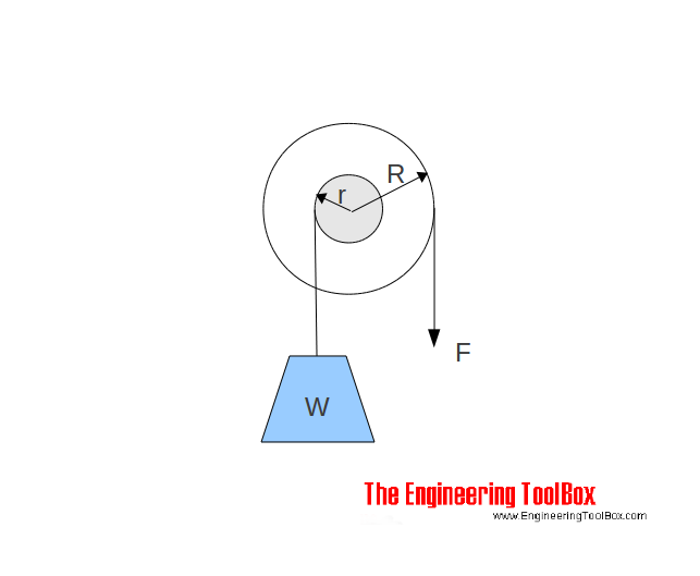

winch effort force and load
A winch is a mechanical device that is used to wind up or wind out a rope or wire rope.
Velocity Ratio
The velocity ratio can be calculated as
VR = R / r              (1)
VR = velocity ratio
R = effort force radius (m)
r = load radius (m)
Effort Force
The force to raise a load can be calculated as
F = W / μ VR
   = W r / μ R
   = m ag r / μ R              (2)
F = force (N)
μ = mechanical efficiency of the system (equal to one for an ideal friction-less system,  a fraction less than one for real-world systems with energy losses due to friction)
m = mass (kg)
ag = acceleration of gravity (9.81 m/s2)
W = weight (N)
Example - Winch Effort Force
The effort force for a winch with small radius 5 mm and large radius 10 mm, efficiency 0.95 and load 1000 kg - can be calculated as
F = (1000 kg) (9.81 m/s2) (5 mm) / ((0.95) (10 mm))
   = 5163 N
