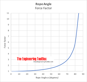

Rope Angle with Load (degrees)Increased Force or Tension Factor
- θ -
- α -
- β -
0 90 1.00
5 85 1.00
10 80 1.02
15 75 1.04
20 70 1.07
25 65 1.10
30 60 1.16
35 55 1.22
40 50 1.31
45 45 1.41
50 40 1.56
55 35 1.74
60 30 2.00
65 25 2.37
70 20 2.92
75 15 3.86
80 10 5.76
85 5 11.5
As we can see from the table above - with
α angle = 60 degrees
and
β angle = 30 degrees
the force or tension F in the rope is doubled.

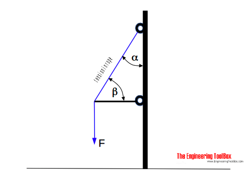

Rope angle and force factor
The force acting in the rope can be calculated as
Frope = θ F                 (1)
Frope = force acting in the rope (N, lb)
θ = increased force or tension factor from the table above
F = load (N, lb)
The force acting in the horizontal beam can be calculated as
Fbeam = (Frope2 + F2)1/2                           (2)
The angle α can be calculated as
α = tan-1(h / d)                 (3)
α = angle (degrees)
h = vertical distance between horizontal beam and rope (m, ft)
d = length of horizontal beam (m, ft)
The angle β can be calculated as
β = tan-1(d / h)                 (4)
β = angle (degrees)

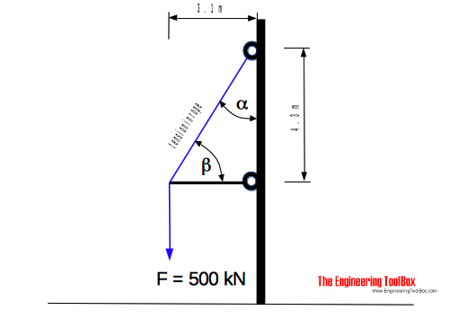

Example - Increased Force in a Rope due to Angle
Rope angle - force and increased tension - example
The maximum force in the rope in the figure above can be estimated by firs calculate the angles:
α = tan-1(3.1 / 4.3)
   = 35.8 o
β = tan-1(4.3 / 3.1)
   = 54.2 o
From the table above the tension factor is approximately 1.22 and the force in the rope can be calculated as
Frope = (500 kN) 1.22
         = 610 kN
